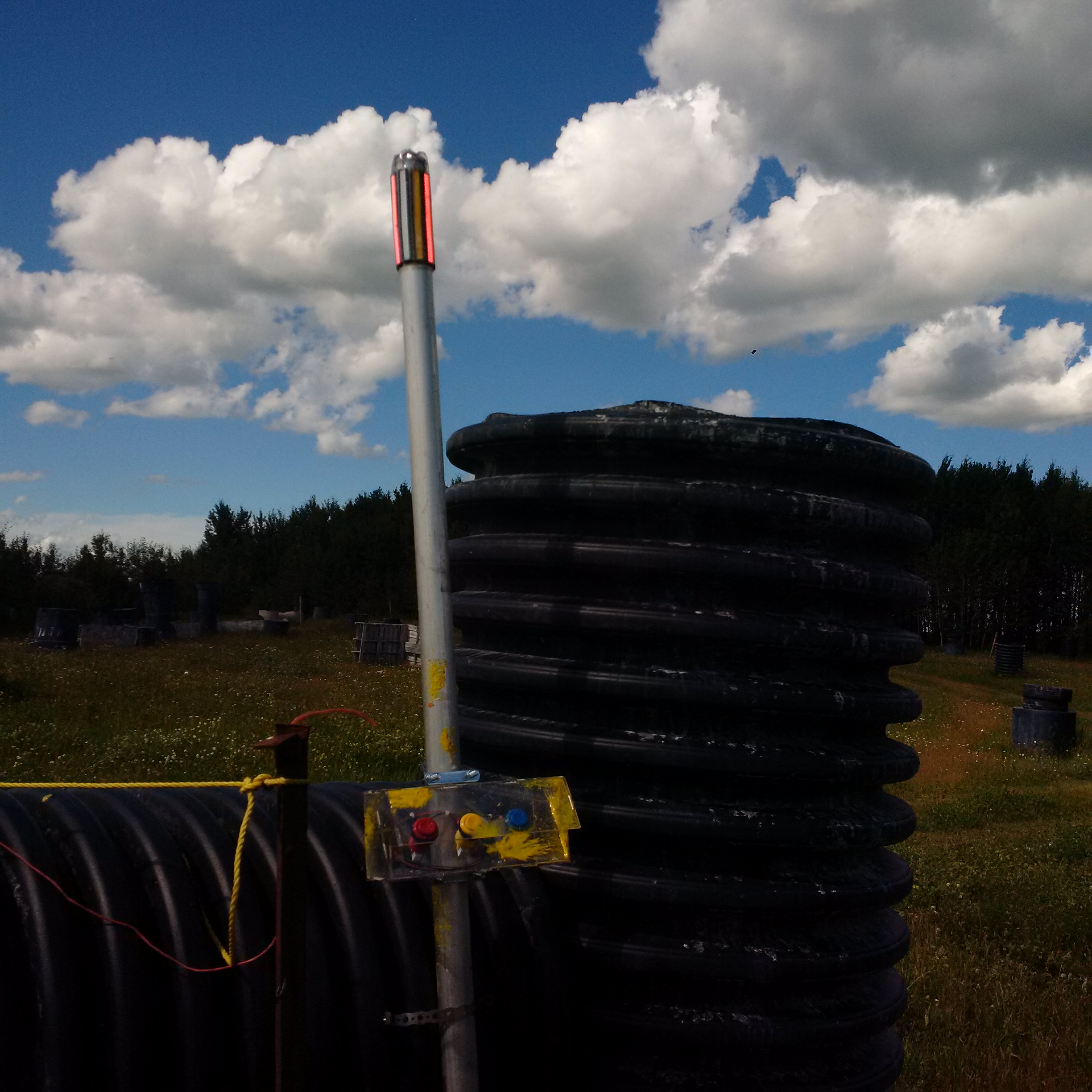

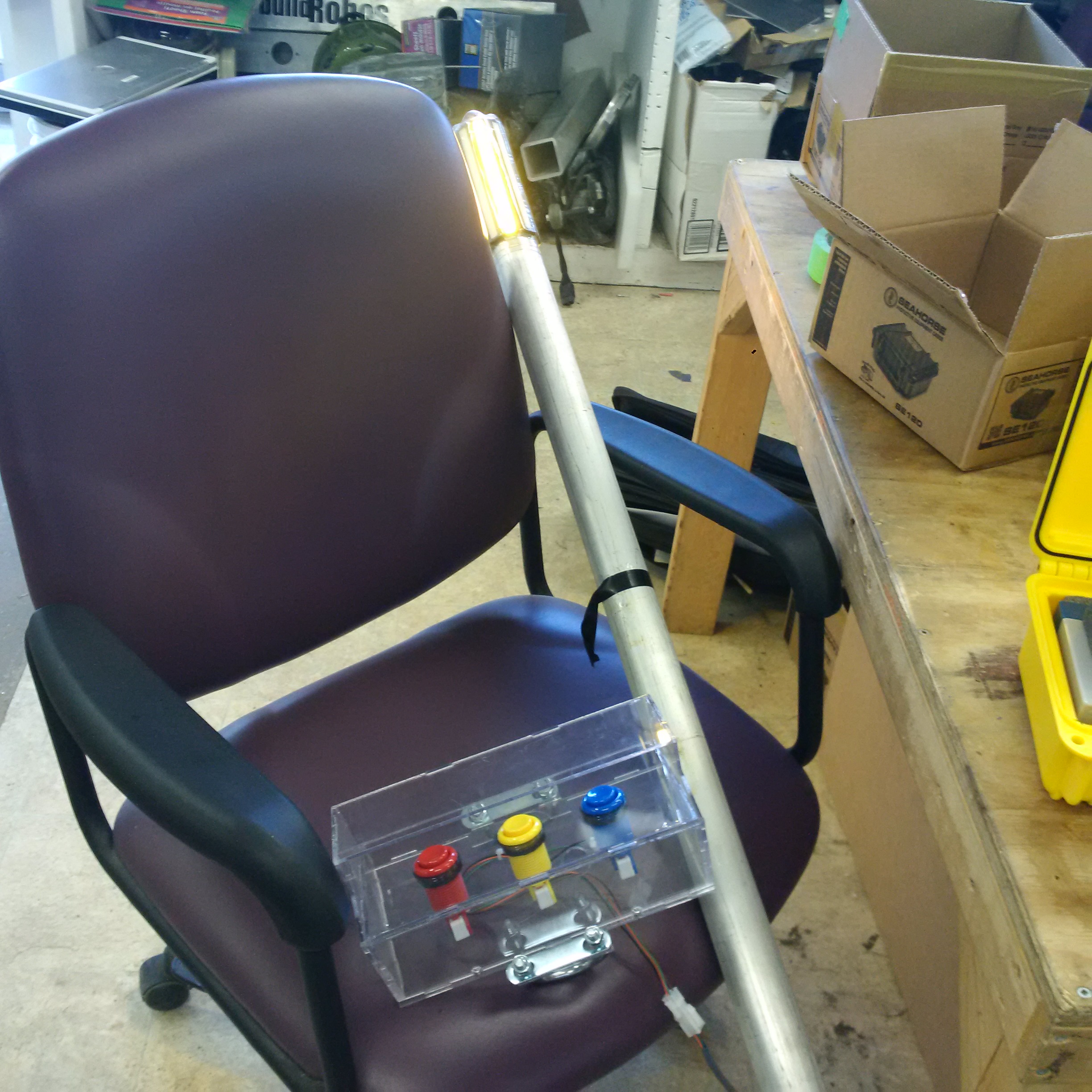

After that, we started talking about a grander scheme. The next game would consist of three bases with buttons and lights. Initially it was traffic lights, but it eventually became the light pole we ended up using. The biggest problem with this sort of “capture the flag” type game is having referees to keep score. If we could use technology to keep score, it frees up the refs so they can focus on fair gameplay. I had been using XBee devices in my “day job,” so decided they would work great for communication between the bases and the command centre.

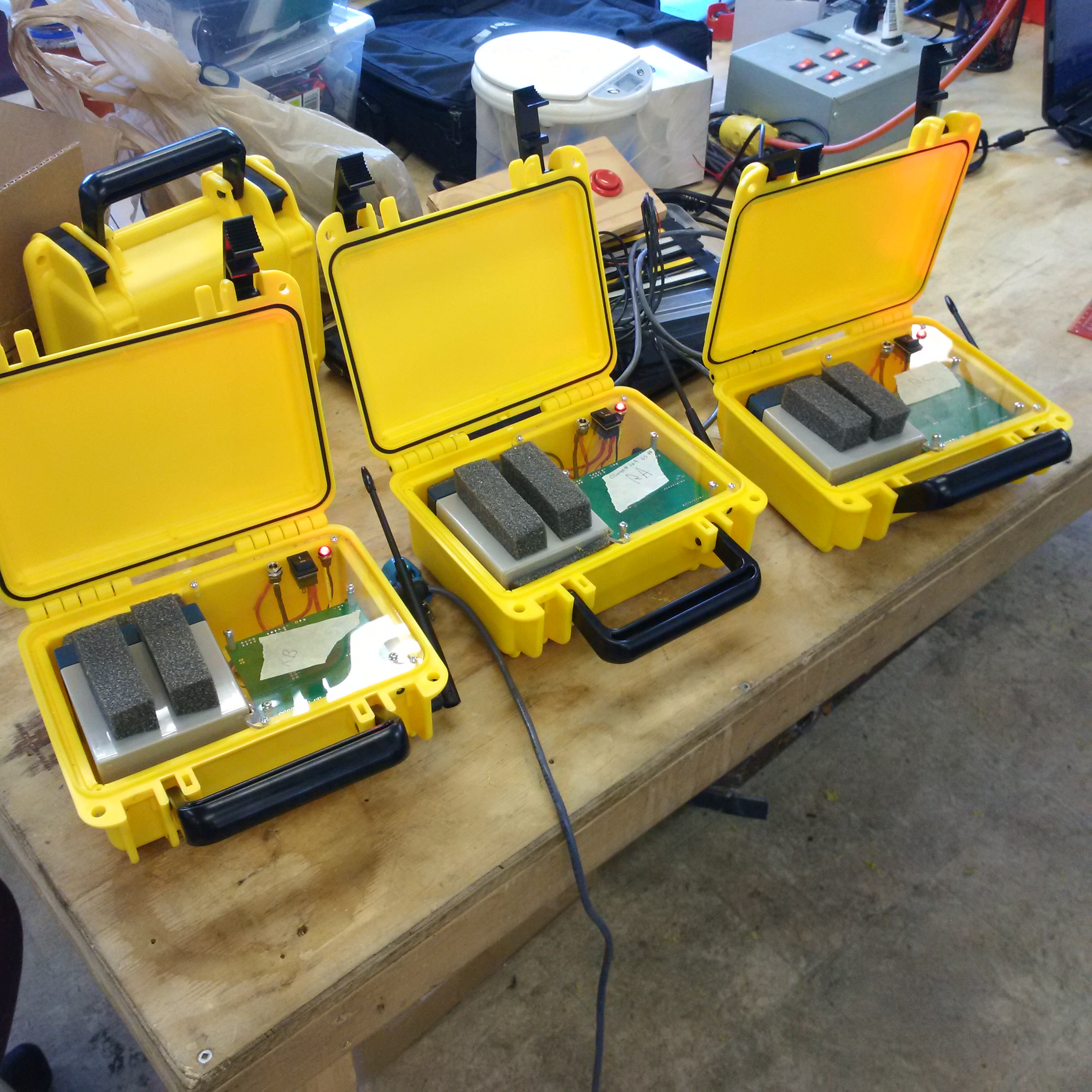

The system I ended up building consists of a Parallax Propeller based circuit board in a Seahorse case with an SLA battery for power. The light pole uses LED strips intended for ground effect lighting and the buttons are standard arcade machine buttons. Communications are provided by XBee S3B-DM modules, which are probably way overkill for the application, but I decided to start at the top rather than have to work my way up until I found what worked. The base station communications is provided by a stock Digi XBee development board connected to the computer by a USB cable.

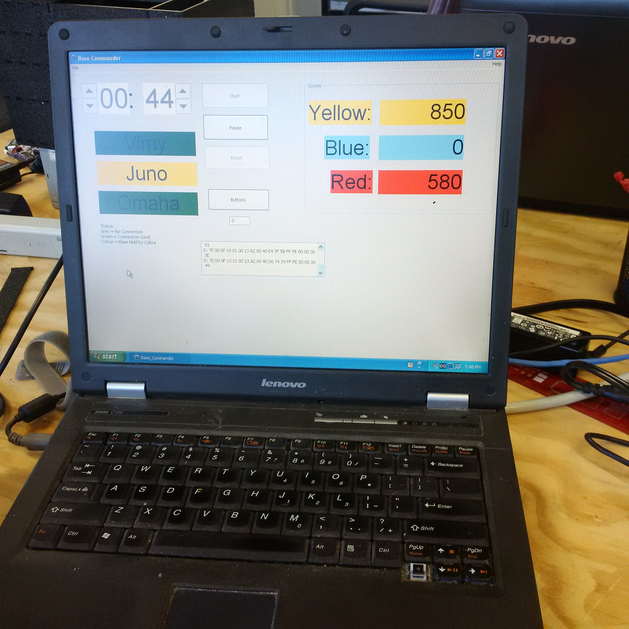

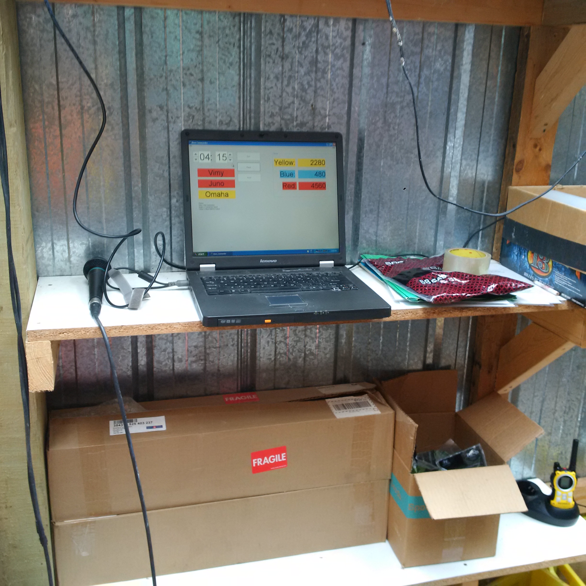

After the initial software developer fell through, I took it upon myself to write the command centre software as well. (I don’t claim to be a software guy — especially GUI applications.) The software monitors the bases throughout the timed game and counts up the score for each team while the base is held by them. It will also remotely reset the base states when starting a new game, and puts all the bases into “win mode” at the end of a game. (They slow blink the winning team colour and no longer respond to button presses until the next game is started.)
The software was written in Free Pascal using the Lazarus IDE. Lazarus is a cross platform development environment and the plan, initially, was to install the software on an older Macintosh laptop. Sadly, I couldn’t get the serial communications library working on the Mac, so I ended up installing the software on an old Windows XP laptop.

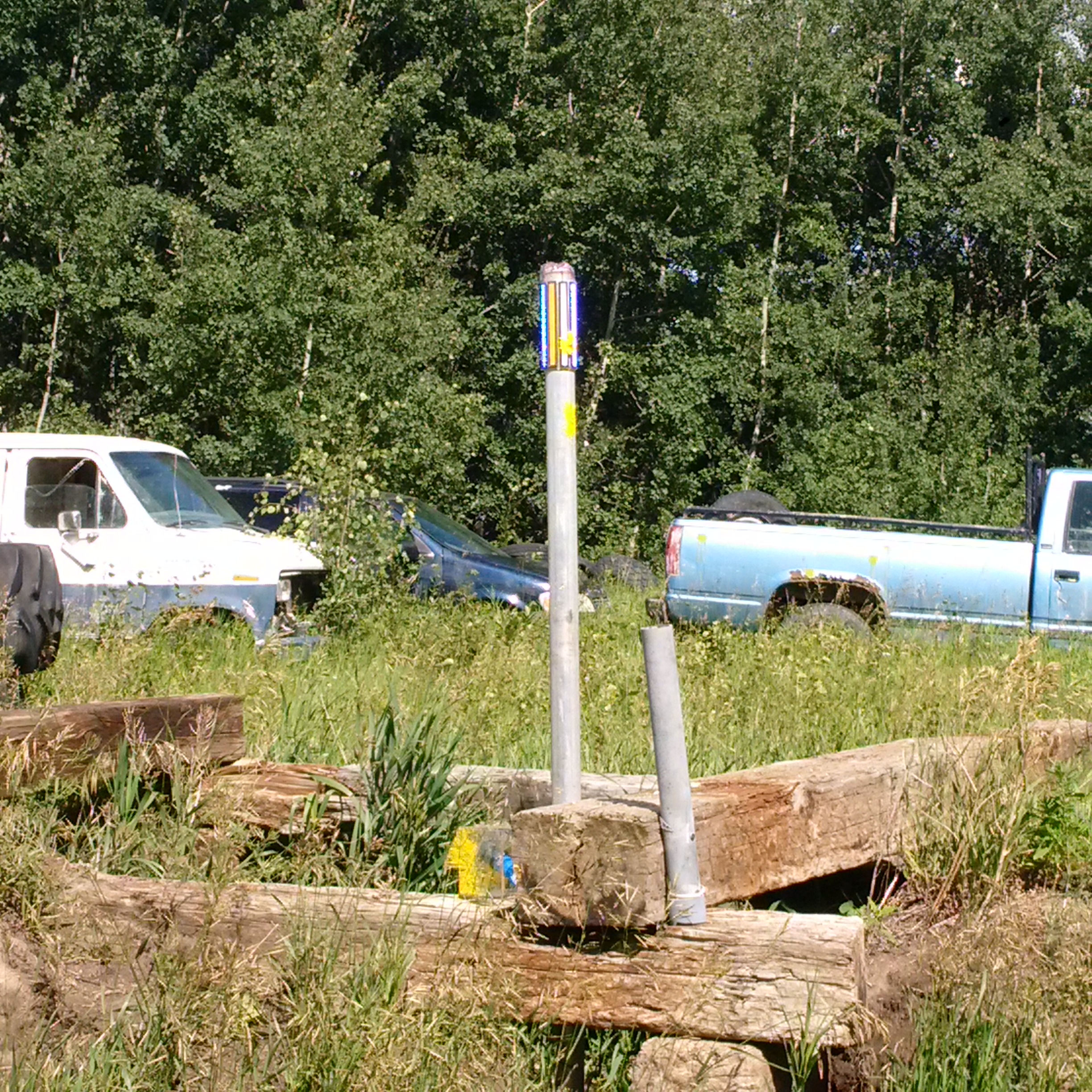

We installed the base stations at locations around the paintball range and set up the command centre in the safe area building. I was a little worried about the fact we had a metal wall between one of the bases and the command centre, but communications was not a problem.
![Speed Bump](http://sktechworks.ca/wp-content/uploads/2016/07/IMG_20160704_154534-512x512.jpg)
![Black Snake](http://sktechworks.ca/wp-content/uploads/2016/07/IMG_20160704_155925-512x512.jpg)
![Command Centre](http://sktechworks.ca/wp-content/uploads/2016/07/IMG_20160704_150436-512x512.jpg)
